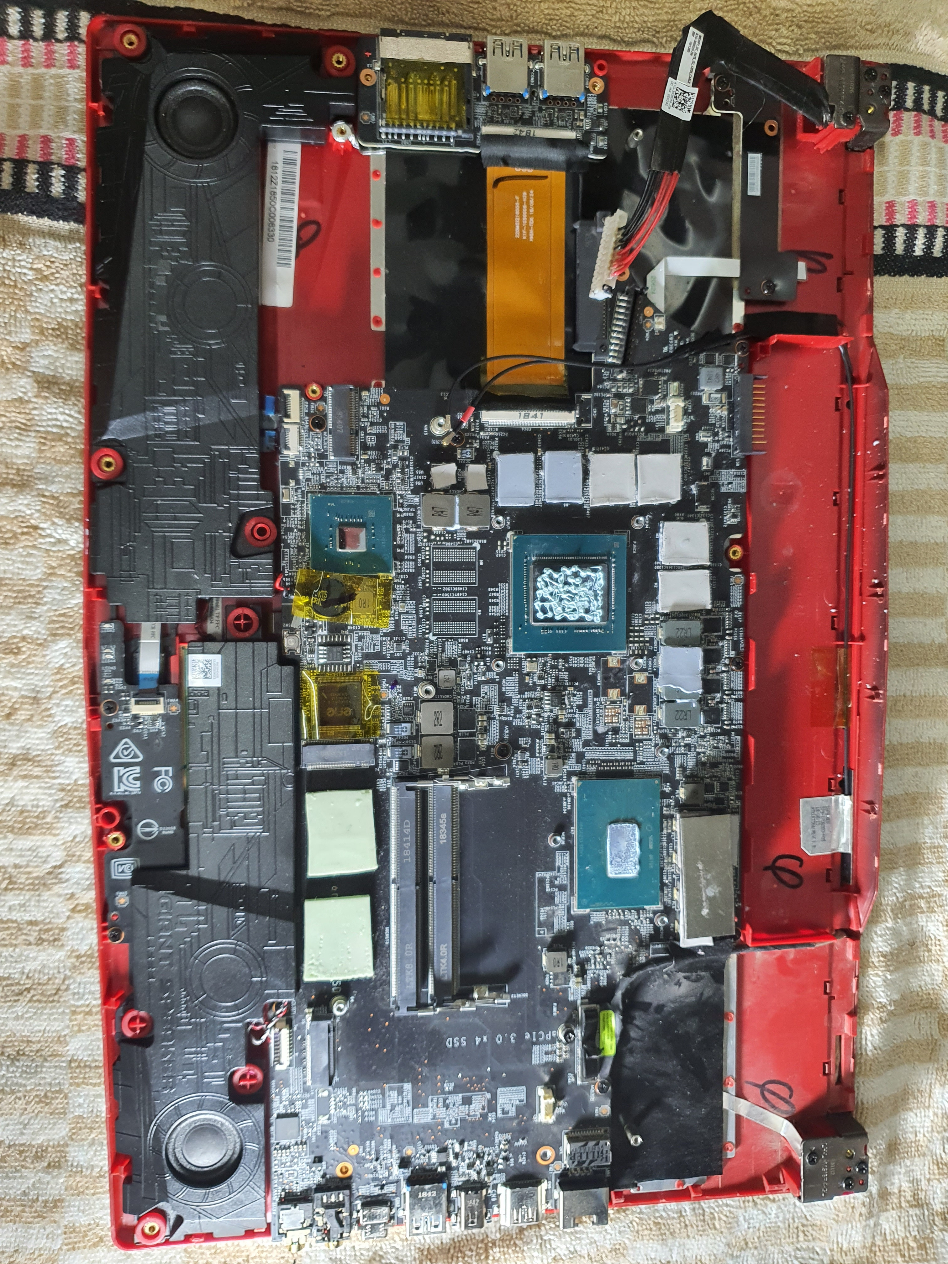

board model is ms-16p7 ?

check under all stickers and also under heat sink

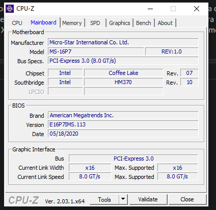

The bios seems to work but i turn on the laptop and it open bios automatically, i can't run system operative.
I tried to update the bios using the bios official of my laptop but now it is frezed sometimes the bios.
What do you recommend to do?

the bios is working OK
please check all things carefully

The BIOS work spectacular (it solve the freezes randoms while run Operating System or when I am in the bios). Now, I have another problem, the GPU no work, for example, when I run a video game, the game run very slow or not work (before of all this, it worked good), I saw the task manager and the use of GPU is 0∼1 percent... Conclution: the GPU isn't work correctly, I think that the problem could be solve if I flash bios of GPU.
What do you think?

It don't work yet. The GPU give picks jumps sometimes and after that go to 0 percent
seems this problem is not related to bios
you need to check all parts of motherboard
